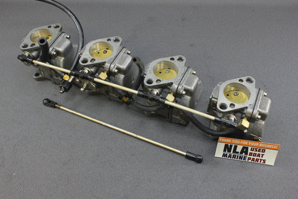

Anyone know where I can find this throttle link, part 19 in this diagram? I searched by the listed part number 825203T but it appears sold out / discontinued everywhere.

There is a boat wrecker in your area I believe.--Lanier Marine Liquidators------I might have this part , but shipping is the issue.

Also check in with NLA marine as they have that part number (825203T) listed with other items in their part number descriptions…,

Will have to search some of these boat yards when I can. In the meantime I found that the break was not too bad, the metal link still was able to snap into one side of the plastic connection. I laid down some super glue and snapped it in and then put some more on top. Let dry overnight and it feels real solid now. Boat running for now, expecting this to fail at some point so will have to source the part in the meantime
