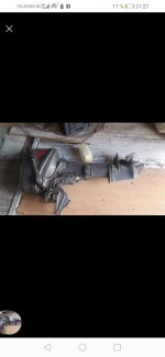

Has metric bolts..looks like a Suzuki to me not Merc. Got a pic of cowling or whole motor?

I am not an expert. I dont know about Suzuki, but is look like Mercury-Mariner comparing with specific book I found on internet. Please tell me if you need more pictures. Thank you.

These motors all look the same 6 , 8 , 9.9 , 15 HP.----So picture of cowling may help.----Carburetor jet size may help.----Is there no serial number sticker ?
