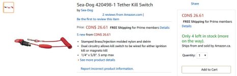

I’m also planning to install a kill switch so looking for recommendations on the best product.
