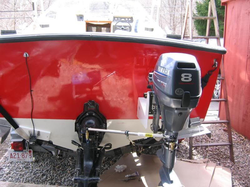

The bracket and air fitting shown in the picture was attached to the top of my Alpha One sterndrive. It is clearly an air hose coupler, but its just a dead fitting, there is nothing connected to the back of it. Can anyone tell me what this was for?

Not sure how to describe it without a picture but its not a fitting for an oil reservoir. I have seen a picture of what you are describing. This is a U shaped stainless steel bracket that was attached to the back of the drive using the four upper bolts that hold on the back of the drive. It has a 90 degree elbow welded to the bracket with an air hose fitting attached to the elbow.

Ayuh,.... Welcome Aboard,...... Sounds like a home brewed drive shower to cool the top end,....
Post yer pictures on photo bucket or somewhere, then post the link to 'em here,....

Home made bracket to connect a rod between the outdrive and an auxilary / kicker motor to permit steering of the kicker from the helm? Air line fittings used for their quick connect / disconnect function?

that is a bracket for a kicker motor so you can use the main engine/drive steering system to steer the kicker motor
