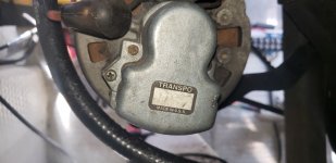

this is the back of the alt I have not been able to secure the S/N yet the tag is worn

So is the heave wire to go to the starter to feed back to the batt switch to charge selected battery . the other wire that hot is that to the voltage gauge to excite the regulator ? SO a low volt indication will have reg close and charge in theory ?

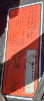

the serial number is on the side of the motor just above the starter. it will be on a tag that is riveted to the block

I believe you have the same alternator I have, or at least very similar. The manual for troubleshooting is attached. I took mine to Advance Auto and they were able to test it.
This link has a picture of your regulator with the wiring labeled.
wiring connections for regulator
Good luck
