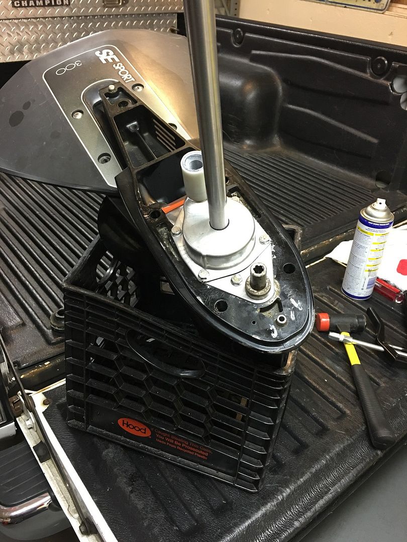

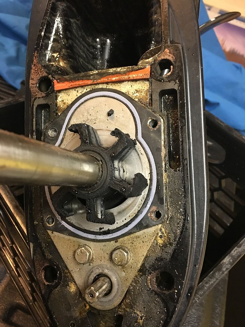

So I got the water pump replaced in my "Tracker" Mercury 60 ELPTO 2004 2 stroke taking it apart was interested and I also was going to replace the thermostat which some people told me not to do or worry about. Well after getting to the old water pump and impeller this is what I found
So we ordered the new kit and replaced everything to do with the water pump.
Wasn't really that big of a deal either went smoothly the biggest PIA was putting the lower unit back in to the outboard. But it started right up....there was a pee stream of water...buuuuuuuuuut it was more of a trickle.....so I thought well lets see whats in the thermostat and replace that.

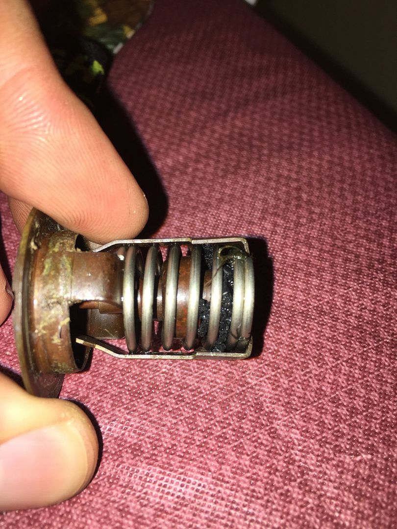

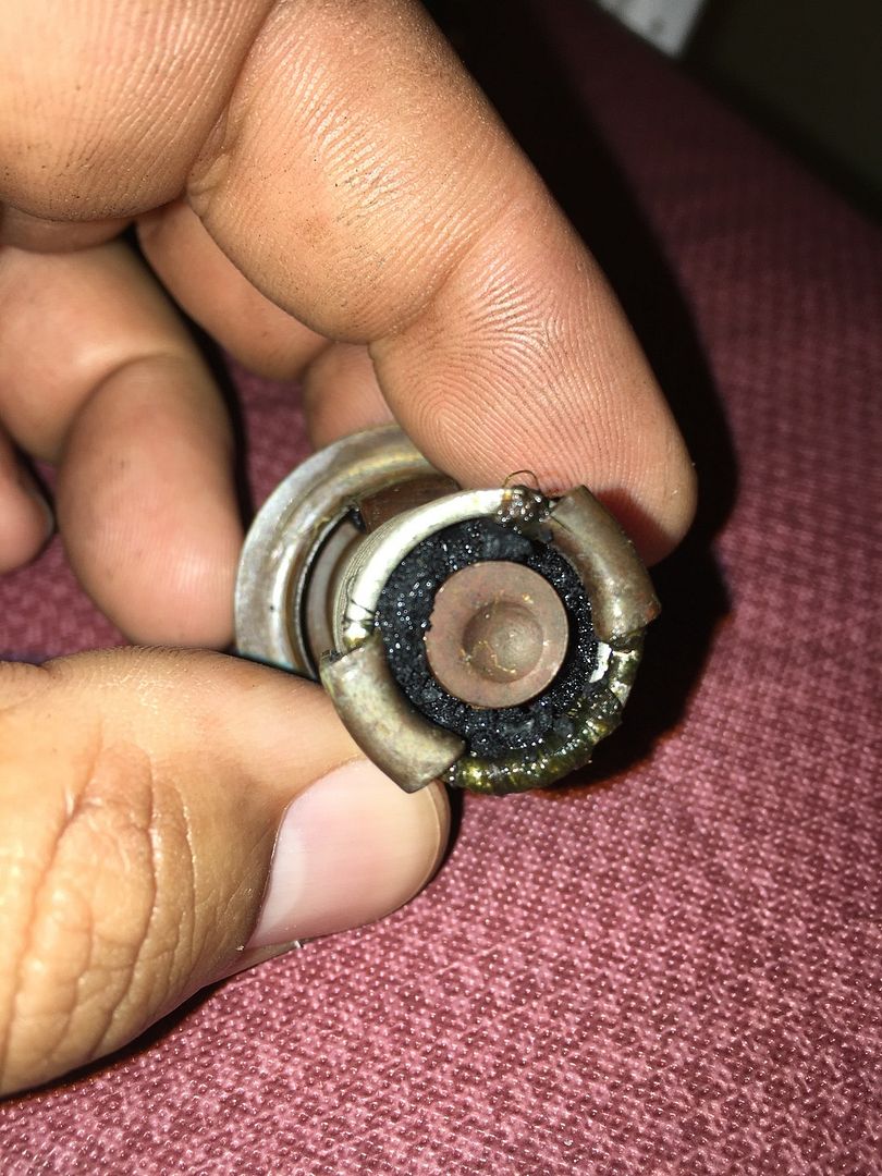

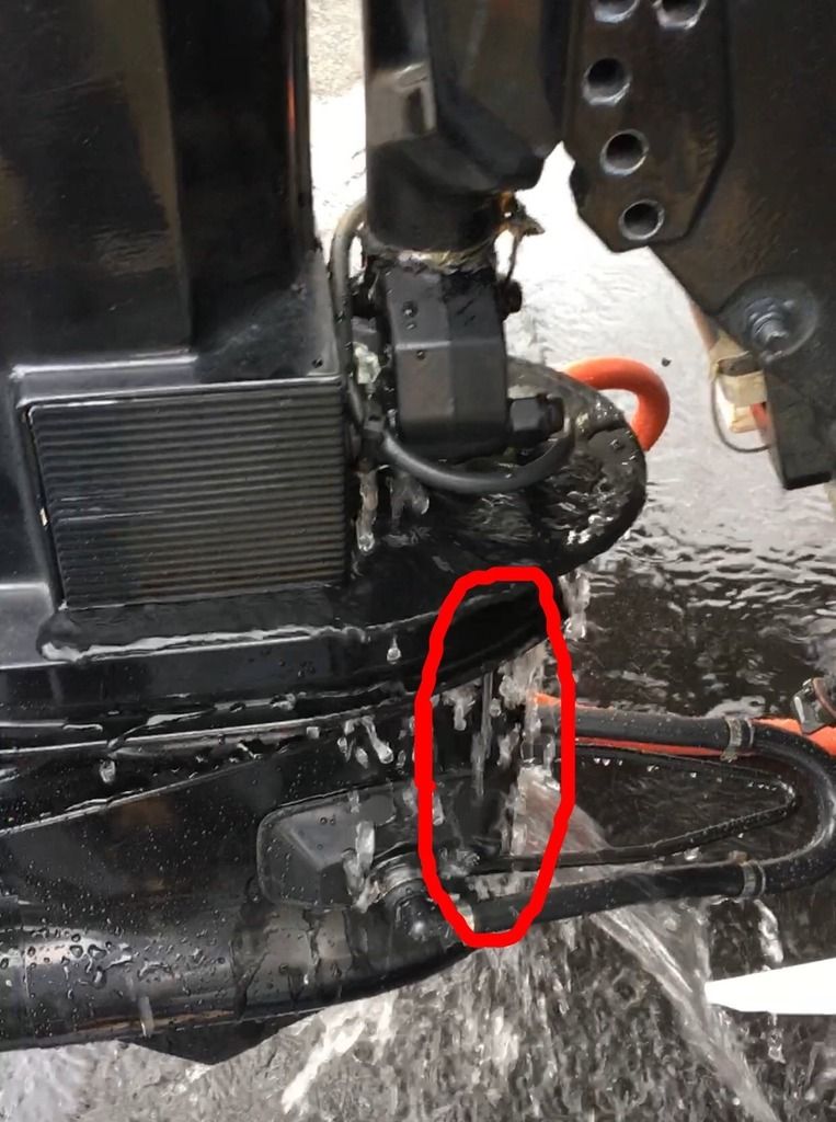

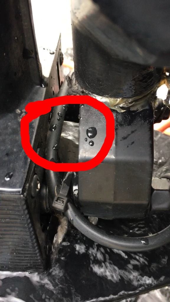

It was all gunked up and there was even some parts in there just sitting around that I scraped out. So I replaced the thermostat and the gaskets as well. Put everything back to gather and yeah.....still not all that great. No change really, while it was running though I noticed water coming out of there places and I am not sure if this is normal because well my first outboard.

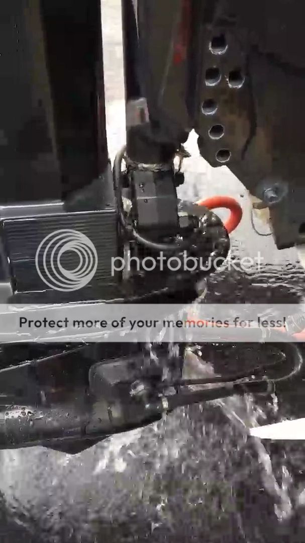

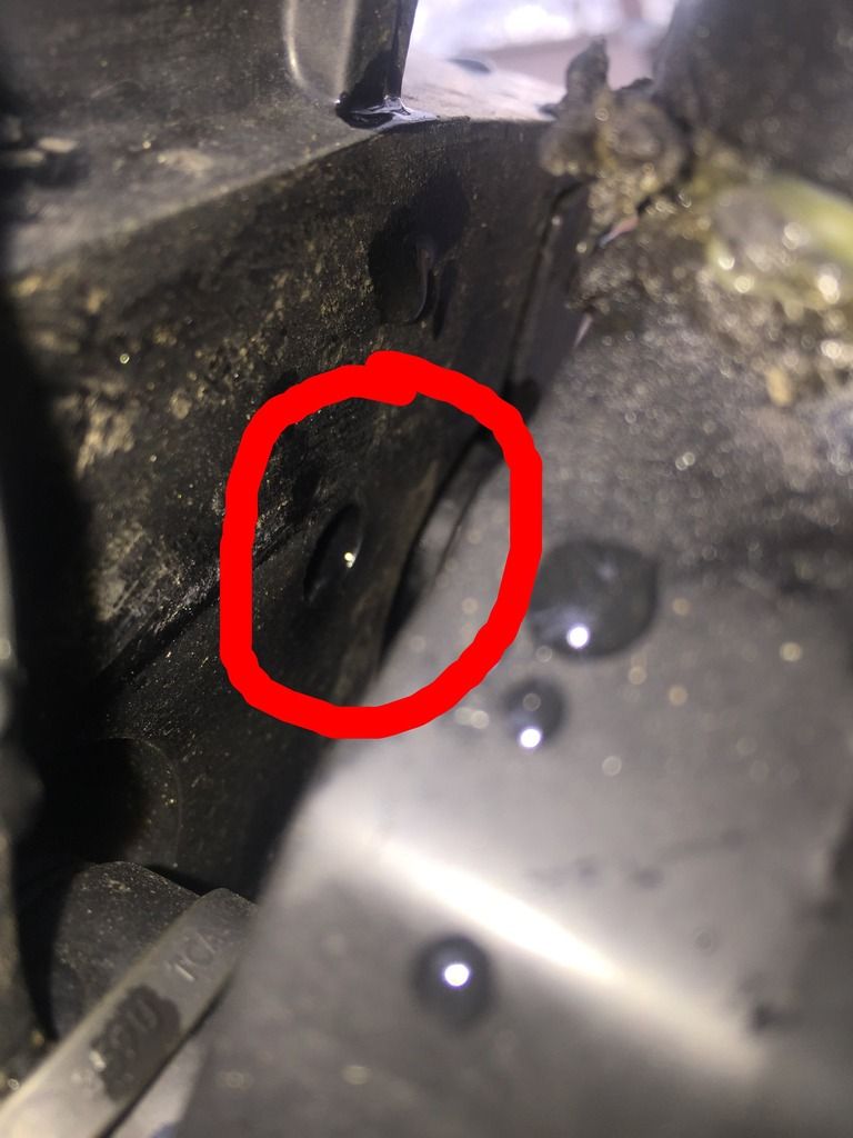

As you can see here circled in red the hole its coming out of and then water coming out of it.
Also there was a spot on the lower right next to one of the bolts where it would come out as well....this one is harder to see because well picture of moving water right. But I am also going to post videos. Right in the middle of the red circle you can see a uniform stream of water coming down the hole it comes out of seems to belong there its not a crack or anything and they are both machined holes.

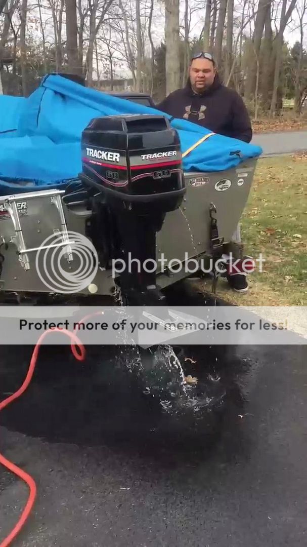

Here are the videos of the motor running.

Didn't see a vid, only hear the sound of the motor.
Seeing all the pieces from the impeller clogging up the thermostat, it could also be clogging up the pee hole

Somebody ran the the motor dry and the shredded impeller is the result. All the junk in the thermostat is impeller bits and there may be more scattered through the motor.
Did you check the water tube for blockage? The water leaking around the lower unit could be from water getting past the upper water tube seal where it enters the powerhead.

I can't tell from the video. Is there water coming out of the front of the lower unit?

You or the PO ran that engine for an extended period with no cooling water supplied. The rubber just ground itself off against the SS pump housing since there was no cooling nor lubrication (from the water). On the TSTAT, bad advise given not to have look at it, especially when you have a 12 year old engine. Obviously you were wise to check it when you saw the impeller.
Can't make much from your pictures on water leaks. Water exits several places normally. The tell tale runs off the exhaust manifold in most of those engines and water is supplied to that continuously, regardless of the temperature in the powerhead cooling water. If you are concerned about volume of water, remove the ⅛" plastic pipe ell at the manifold cover plate while the engine is running on muffs and clean it out with a wire. Then reverse blow through the hose with compressed air before you put it back together.

Looks fine to me. The junk in your thermostat were chunks of your rubber blades off your water pump. Plus your motor having a thermostat running off a cold hose doesn't open up all the way. You get it in the water get it warmed up and under a load it'll be pushing more out the pisser. The holes are there just so water doesn't sit in your exhaust housing and freeze.

GA_Boater Yeah there was little rubber bits all over the place, thankfully we were able to clean the new thermostat out since some little bits got stuck in there too! Still trying to figure out if the water coming out of those other 2 holes is normal. Gotta go to the marina soon anyways so just going to ask them.

If it's plumbed like it's bigger brother (90 triple) the stat has nothing to do with it. Water comes directly from the exhaust manifold cover and that isn't in the tstat circuit. Will agree on more water on the water as water pressure and higher rpms will increase the volume/pressure of the pump output.
