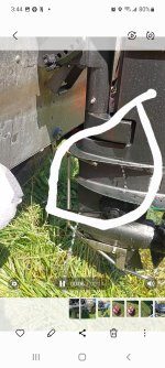

I just recently upgraded from my 1997 Johnson 9.9 2 stroke to a 2000 Johnson 15 2 stroke(used) previous owner gave me receipt of the service done by mechanic which included new impeller, spark plugs and gear oil. Brought it home put the muffs on and fired up. Water pumping under cowling and under cavitation plate. The issue is it's also leaking out mid section which I'm not sold is supposed to happen. I understand using garden hose ads pressure so i then tried in a barrel and still leakage. My 9.9 never did that. Maybe different model is the difference? Took it fishing and motor cut out after running full throttle which is a gas issue that hopefully is fixed but won't know until tomorrow. I'm using same tank, same fuel from my old 9.9 which never has any issues whatsoever so I'm confused. After getting back I drained lower end oil to see if any water go in and it was still new, no water. Would running it 10 minutes in the lake be enough time for water to get in? Is there drainage holes in mid section I'm not aware of. I am attaching a picture and video for reference.

That water coming out behind the lower mount is normal and intended. It is supposed to do that. If it didn't, there would be a problem.

Not sure everyone knows that first picture is a video.
Also, not sure why water is coming out there but tell tale seems to be pumping well.
