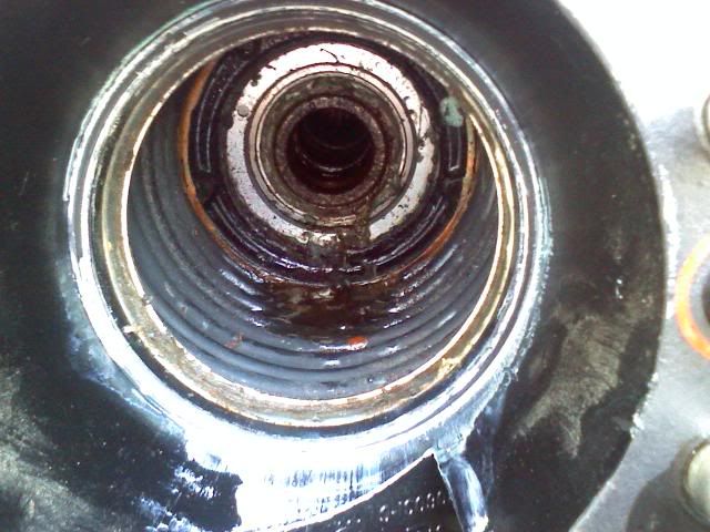

This pic is off the shaft bellow there was just a little water in it as you can see. Looks like the boat place i took it to did pull the out drive off and gerased every thing for winterization. But i would have thought they would have told me some water was in there and that the bellows were going bad.
So even with that little water in there that bellow needs replaced i take then?
The gimble bearing is in the middle back right? i spun it around in there and it move great. Not ruff at all spun very smoothly.
this pic is of the hole lower left of the shaft bellow. had almost no water in it. but there was a little that looked like condensat.
this next pics are of the drive shaft. the u-joinnt moved freely no catching or grinding at all. the grease on the spline is dark but it is on there very heavy.
there is very little rust on the shaft at all. As you can see and it is very light.
But does that mean there is some thing else going on.

Did you look at the link i posted?
Call them and you can get the same kit without the gimbal bearing if your bearing is ok..
Save you about 30 to 40 bucks on the kit.
I bet that little bit of water was from the small nick i noticed in the pictures..
Looks like you caught it in time...;)

To my eyes I see excessive rust around the inner gimble bearing and rusty colored grease coming down from it. Did you feel any friction whatsoever when you stick a couple of fingers in it and turn it 360 degrees?
I agree....for the price of the kit and its already apart why not just put a new bearing in...
Good piece of mind is worth it...;)

yeah i think i will just put a new gimbal in. might as well since i'm all ready there and got it torn down.
