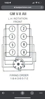

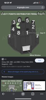

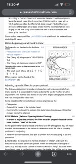

Good morning I’m reaching out to anybody with knowledge on an issue I’m having. I have a 1984 Bayliner 2850 I believe it is an a Q260 with a engine GM350 SBC VA. I bought the boat a few months ago it was running rough I changed the alternator and the starter ran better couldn’t get the idle correct so I recently purchased for plug wires spark plugs distributor cap distributor rotor. Asked a friend to give me a hand who claimed to be a mechanic now my distributor doesn’t look like it’s in the same position I’m not sure where number one is on the distributor cap I’ve looked at several images online several videos online several tutorials a lot of people have different ways of doing things which is understandable but the way I did it I followed the majority of people that were doing it in one particular way. They used to run rough now it doesn’t run at all. I definitely need some serious advice and or help . The distributor cap before things were moved around was in 180° different rotation that is now the advance was facing the rear of the boat as well as the window since I had been taking advice off of YouTube and other information it said that the advance needed to be facing towards the front of the engine as well as the window and that number one on the cab was directly over the window on the port side and then I have followed the firing order from there I honestly believe that I have the distributor and or distributor cabin wires backwards. Any help would be great. So tell me if I’m wrong. Look at the pictures below, the picture of the Is the same cap that I have so position one is above the window and the window should be facing the front of the engine(bow of boat). When I first got this boat, This was facing the back of the engine (stern). This is where I follow the fair in order for the wires. I do not remember the firing order it was originally in when the window was facing the back of the engine. I did remove the distributor and before they reinstalled it they put the engine at the number one compression stroke but the only thing I forgot to do was mark the position of my rotor.

I never pull a dizzy without marking the base of it where it meets the block and also marking the rotor location on the plastic housing. You will be at #1TDC twice. Once on the exhaust stroke and once on the compression stroke. Are you sure you are at TDC on compression? Ensure that, and then you will probably need to pull the dizzy and stab it again where the cap says #1 should be with the cap facing the right direction. Once that's done you might have to barely tighten the hold down bolt (still somewhat loose) and turn the dizzy left or right a bit while someone else cranks the engine.

I can do the work. What do you suggest? As of now I’m at a loss. I’ve worked on engines before but for some reason I just can’t figure this out. I’ve done compression testing on all 8 cylinders and compression has passed. #1 is at top dead center, returned distributor back with the rotor pointing at the #1 cylinder/spark plug location. Followed clockwise attaching wires in firing order 18436572. Plugs, wires, rotor, cap, & ignition coil are all new. As I attempt to turn it over I get backfire from the carburetor. So I don’t know what else to try.

You need to have the engine at TDC of the compression stroke for # 1 cyl which means that both valves on # 1 cyl are closed and the piston is all the way up to the top of the cyl. You may be 180* off with it on the exhaust stroke. In this case the exhaust valve will be open but the intake will be closed. Might be easier if you have the valve cover off on that side to watch the valves. When they are closed the valve stem will be all the way up when they are open it will be pushed down by the rocker arm.

To find #1 remove #1 sparkplug and dist cap. crank motor till you hear a "puff" of air. This is #1 compression stroke. Now look at the timing mark on the harmonic balancer and turn motor until timing mark is on zero.
This is TDC of #1 wherever the rotor is pointing is now called number one position. firing order is 1,8,4,3,,6,5,7,2 clockwise.
