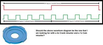

Wondering if anyone has an idea and can help with a Volvo Penta gas inboard 5.7 Gi-J multiport FI that refuses to start due to lack of continuous spark? Scanned it and scoped it. Symptoms are during cranking only three or four spark events occur initially and then none. However will run rough with cam sensor unplugged. Can see initial three or four sparks only, visually and also confirmed ICM signal failure with scope when cam signal present. With cam sensor unplugged spark will continue during cranking. Three channels monitored with scope. Crank signal, Cam signal and ICM. Crank sensor replaced for the heck of it - no change. Coil and ICM replaced - no change. cam and crank sensor scope signals are showing clean and consistent 0-4.5 v highs and lows however....I deduced that it should have a 4x crank reluctor installed and I'm only getting four equally spaced high / low 0-4.5v signals for each revolution of the 1x cam signal (one high and one low). One revolution of the cam should be two revolutions of the crank therefore should I not see 8 spikes of the crank signal over that time instead of four? The odd thing is that both cam and crank signals seem to be quite clean, consistent and correct voltage ranges (decent square waveform). Does anyone know if this ecm uses the GM ignition bypass circuitry during start phase? Scope back probed at ecm & low pass filter off. This engine was a running engine not so long ago.

Thank you guys for your replies, the only persistent codes during scan were trim voltage too high (the leg trim sender has its wires disconnected) and buzzer circuit open. engine SN is 4012227089. The strange thing is the ECM logic in this case which allows the ignition trigger output to the ICM to work continuously when a cam sensor signal is not present (even if another cam sensor is plugged in alongside distributor it continues to spark) as long as there is no cam reluctor signal coming back to ECM, as soon as the cam signal is present the anomaly of 3 or 4 initial sparks and then none after that with continued cranking occurs. I read the thread about the 3x reluctor wheel being installed where a 4x should be (Mattsomething) who struggled with similar spark symptoms and cam sensor effects.....in that thread an obvious inappropriate (for his engine type) crank signal led to similar observations in so far as the spark goes. In Matts case he had a new engine build with the wrong reluctor installed, in my case this is not a new engine build. The only similarity with Matt is that I seem to have an inappropriate crank signal (half the number of peaks that I should see relative to one full cycle of cam signal). I'm wondering if the sensor is too close to the reluctor (needs shimming) and perhaps the front main bearing is a little sloppy coupled with the alternating crank loads imposed by the front cylinders causing a consistent yet messed up signal that misses every other slot on the reluctor.....just a theory....those 4x reluctors dont look like the slots are very deep, is it possible that the sensor sees metal when it should not due to lack of concentric proximity / air gap? Going way out on a limb here to try and avoid blaming the ECM. My mechanic friend has DMMed the 5v reference and associated grounds and done extensive continuity / resistance measurements of the signal wiring in the harness and can not find anything there.
Thanks again for your input....and yes we will look at the oil PX signal also.WaveForm.jpg

I can't help with the screenshot of the scope, never used a scope on these engines. But the waveform diagram you show in 2nd post is very close to what is printed in the VP classroom study guide.
