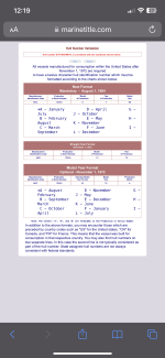

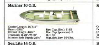

I recently purchased a StarCraft boat from a young man who knew nothing about it. After some research I believe I have a 1975 Mariner O.B. That’s where everything gets weird. The boat was registered in Minnesota as a 1974 with a hull ID 992591. I have learned that every boat starting in 1972 is required to have a 12 digit HIN. I found the tag on the upper right transom and it only leads to more questions. It’s a 14 digit number that I have tried to enter into the HIN decoder https://www.marinetitle.com/library/hull-identification-number.aspx in every combination I can think of with no luck. Any assistance will be very appreciated. I’m trying to title it in Florida and I have hit a brick wall.

roscoe
Oct 30, 2002
21,896
So it only works if I pay $20?
If you use that website, yes.
They are charging you for info that is available for free.
Try the site that jb had posted.
Www.hindecoder.com
boat was built in December of 1974, probably originally sold as a 1975 model, which was common.
Where did you get this from???
""with a hull ID 992591"" ?
