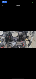

I know there is a Volvo Penta intake on it, pn 3856270

I’ll have to get better pictures tomorrow, I posted the best ones I have for tonight if that helps at all

From the pics and numbers it appears to me (note maybe only me) that this is a VP motor that was replaced by a Merc reman.
OK, seeing the Holley carb means the Merc reman has had the VP carb, intake and other stuff installed on it. So it's a GL model (2 BBL)
You essentially still have a Volvo engine combination...Was there still a plastic cover over the flame arrestor that said 5.?G??? number and letter wise?
Here should be all your engine and drive parts and it looks as if you originally had a 5.0GLPWTR, https://www.volvopenta.com/shop/0?serialnumber=4110187224

Honestly probably no real need on our part to add more as the 2 photos above helped tell us the story and find the info you need to move forward better at finding all the parts you'd need.
But again this boat went from a 5.0 to a good 5.7 engine.:cool:(y)...Enjoy.:)
