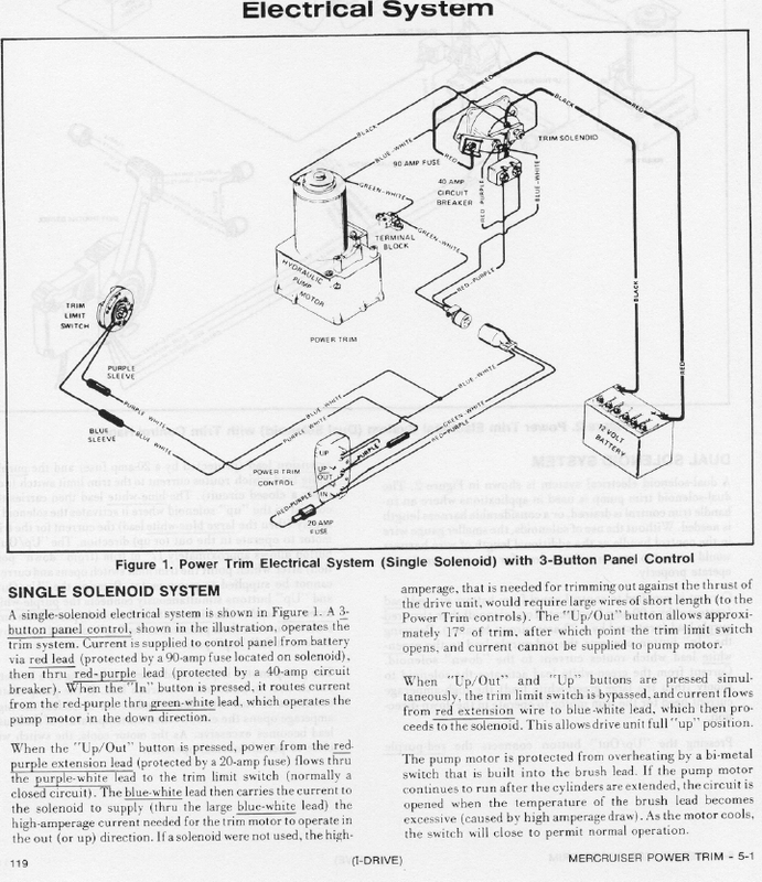

Here is another wiring diagram and description for the single solenoid ckt.
