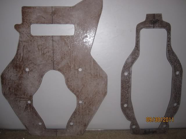

mxcobra, I made these, but I already had the 1/8 masonite in my garage. I traced the inner and outer transom plates.
The patterns made it easy to layout the transom and they are dead on. I could have done it much quicker by tracing the the hull, however I take pride in always doing things the hard way:D. You'd think I would learn.

I didn't get a good spec from the cardboad. I would use foam sheets.
