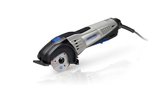

I'm not sure where to begin exactly on this project. I recently acquired the following tool, which I think will come in handy:
