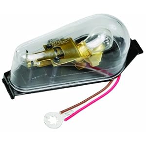

Re: Trailer Lights - 96 Bayliner Capri
Does this look like yours?
http://www.amazon.com/Wesbar-Sonically-Sealed-Waterproof-Capsule/dp/B002DP9W22
I was under my trailer and boat last night replacing my trailer lights so I feel your pain. Just do buy new lights, housing and all. I got mine for 9.99 a piece (small potatos for a boat owner). Just make sure you buy the "submersable" ones. Made that mistake once.
