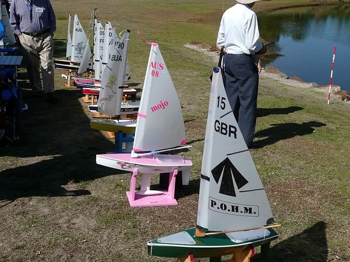

I got interested in Wee Nips (Strathclyde 70) RC Yachts. You got plans, ply, glue, resin, tools etc etc and build one. It was beyond me so I got someone to do it for me, and a lot of men are like me. Hence I came up with idea of rotomoulding them in plastic, so you bought a one-part hull, with everything vulcanised in so you would be up-and-running in an hour.

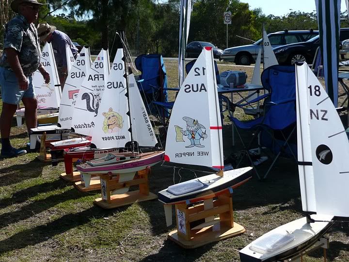

These are the plywood ones at our group
They are not the fastest RC Yacht, but they sail exceptionally well.
I understand:
In Scotland a teacher split his class in groups to design, construct and sail (race) a RC Yacht. They invited a Naval Architect, Graham Bantock, to judge. The story goes, many sunk or failed to finish, so he went off and designed this yacht, meeting several criteria - build by kids - cost - sail well etc etc. I understand there is a large competition in Scotland, where schools split classes into groups and this is their task - winners go forward to compete with other schools, and winners go forward to district competition etc. That's what I understand.
The difference between these and the other RC yachts mass marketed is, others are copies of sucessfull ocean racers - scaled down - and none sail well as you can't scale down conditions. The Wee Nip was specifically designed for its use, and sails beautifully.

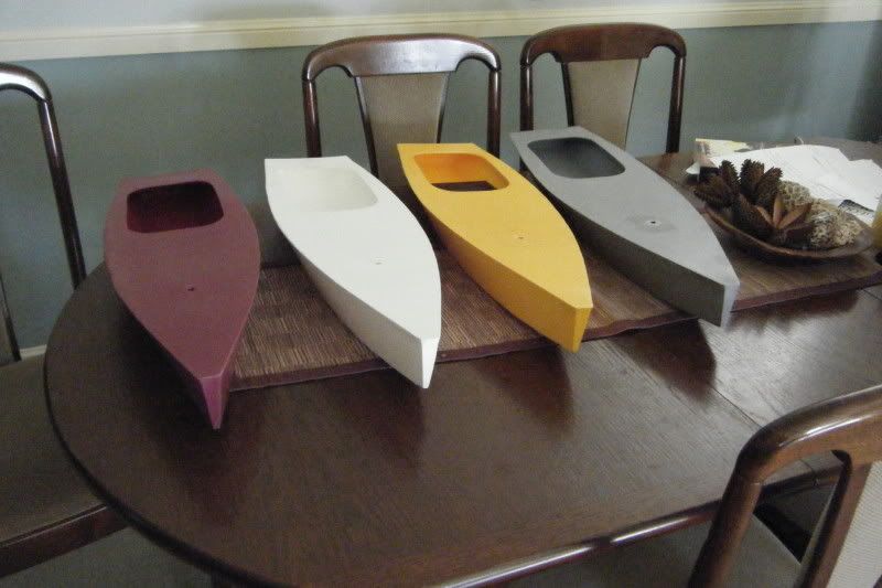

I went for the rotomoulding process - put shot (fine plastic beads) into the tool, and rotate in an oven - just like making a water tank.
I had tooling made and produced these prototypes
The yellow and white ones we built-up, each with components made of different materials, and both sailed sucessfully.

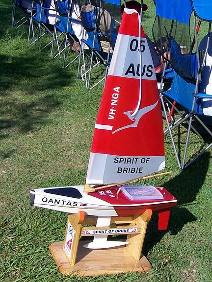

Here are the yellow and white ((painted top orange to test adherence).

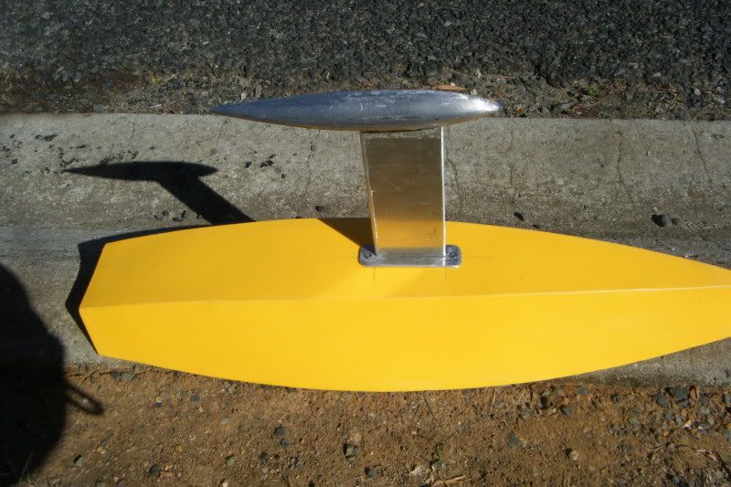

The construction of both boats is very different in components used. Yellow got all alloy parts bolted and rivets, white/orange all plywood glued.
16AlloyKeelsetinalloymountingplatethensecuredtoHullLeadkeelbulbattachedwithpinsandglue006-Copy.jpg

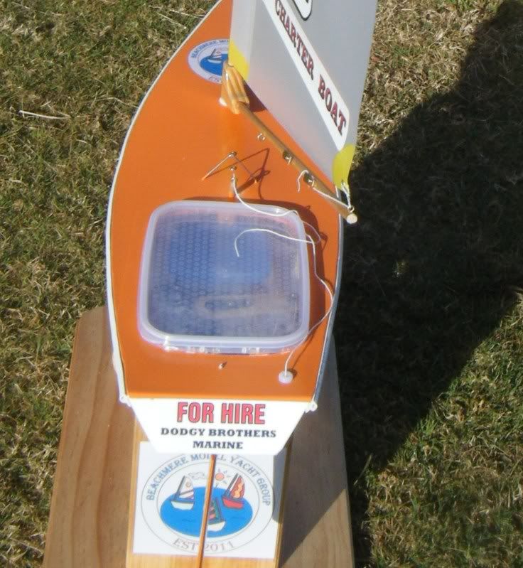

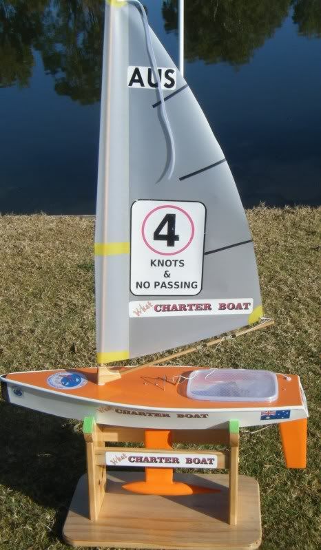

Here is the orange/white one.
I opted for the alloy plate components in the yellow boat.
Probably sounds stupid, but when I use to watch Tim the Toolman I was impressed by his rrrrrrr-------rrrrrrrrrr--------rrrrrrrr noise when he saw something he liked made out of wood, or shiny steel, or 'good' tools.
I also noted his wifes reaction to him.
My conclusion - blokes like blokey-looking things, and i reckon alloy parts are the go - a real selling point.
I drilled plenty of holes in them to increase the blokey-feel. Anyway....
Both boats sailed really well.
I dismantled the yellow one and transfered parts to one made out of a different material, shiny surface, very quick.
All alloy parts were hand made, and given to an engineer to run off 100 of each part.
They look good.
Have considered powder coating, annodising, black nickel etc, but feel the alloy look the best for the moment.
Had tooling re-designed so the keel plate is counter-sunk into the plastic, nuts vulcanised into plastic, so assembly is 60 secs at most.
Also vulcanised in a tube for mast, tube for lifting hook, which increased structual integrity of the hull and should alloy me to come down from 800grams to hopefully 550grams.
