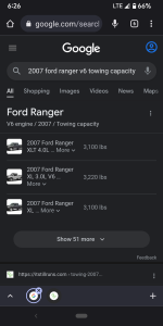

Would a 3rd generation Ford Ranger (1998-2011) with a 3.0l V6 tow a 1967 18 foot aluminum StarCraft safely.
The boat has a 75hp Suzuki.
My searching I've come up with everything with trailer is still under 2500lbs.
Just looking to see if any tow with their Tacoma or Ranger.
I've posted a screenshot of some 2007 towing specs.
Thanks

With a standard set up 18'r and a 75 hp motor it should remain very light being under the Ranger's towing capacity.
My 18'r is a different story with a 115 hp, double decking, 4 batteries, livewell, 24 gal belly tank and a 24v TM that weighs 90 Lbs.

1,605
