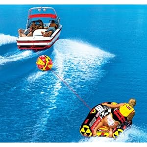

Re: Tow rope gets caught in wake when towing tube
How about a booster ball?
I will go with the liklihood that the u-bolts he is using are probably too low to allow sufficient height above the water for the rope. The skier success is due to the taller skier creating an andle which is enough to keep it out of the water. The rope-rulley he is likely using between the tow hooks, is exasterbating the problem. The booster ball is about the only thing that will help if he doesn't want to create a new mounting point or raise his tow eyes.
