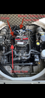

Found this pic on my phone wanted to show you for reference this 15Amp fuse I’ve mentioned. Wondering what it is and why it’s blown. I’ll post back later with wire colours and a better pic but maybe you already know what it would be.

Don't know what the 15 amp fuse is but might be the fuel pump or ignition. With it blown does the motor run

The 15 amp fuses in that area seems to had been more or an additional part of the ignition accessories system that Merc added around that era… it tends to seem to blow if you use other accessories, such as a pump to blow up at inner tube,, raft, etc. from say the helm accessory power plug but if you found symptoms of a wire getting hot at an accessory type device that is motorized with a plunger then possibly it’s somehow intertwined though seems doubtful due to the wiring coloring that I can recall anyways.

I will take a better pic of 15amp fuse tonight and see what colours the wire is and post back.

You can test the theory without replacing the thermostat or diode
Remove the 20 amp fuse
Install a jumper where the diode use to be
Fire the motor up and see if the hissing stops after running for a while
Oh great thank you I will definitely try this.
So when you say jumper what do you mean exactly. Point A to point B. Sorry dumb it down a little for me lol.
And if the hissing goes away then the fix is new diode and thermostat? Is this what you’re thinking.
Sure hope so!! I’ll be so thrilled. Love being able to fix an issue and learn while doing so.
Now just need to figure out this 15Amp fuse. FT has an idea. I am going to get some pics and wire colours and report back tomorrow.
I’ll be running the boat this Saturday.
Cross your fingers fellas.
Thanks a bunch guys.
Cheers.
