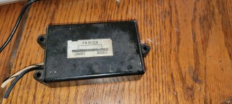

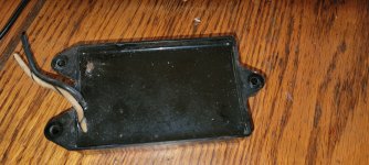

Thyank You Chris. It's a 1986 175 hp Mariner. Chris I'm not sure it has 3 wires coming out of it and all it says is advance module enclosed is a pictues
It's not an oil sensor I know I just put that on there where I could find it lol
Chris it is a spark advance module no longer made.Hopefully I can find a used one. Not really sure what it does? Do You?

1) Is this module bad?
2) It advances the timing of switchboxes by varying the ohms resistance of bias circuit in switchboxes.
3) Really dont need it....just set timing at 22° cranking and go.
Yes one of the wires is burnt up all the way up in the box. 22 thank You so much for Your help!!!
