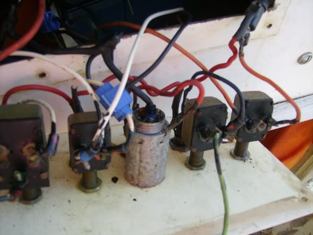

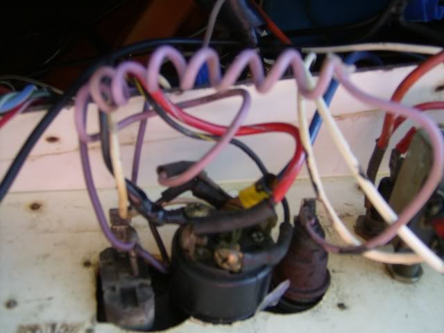

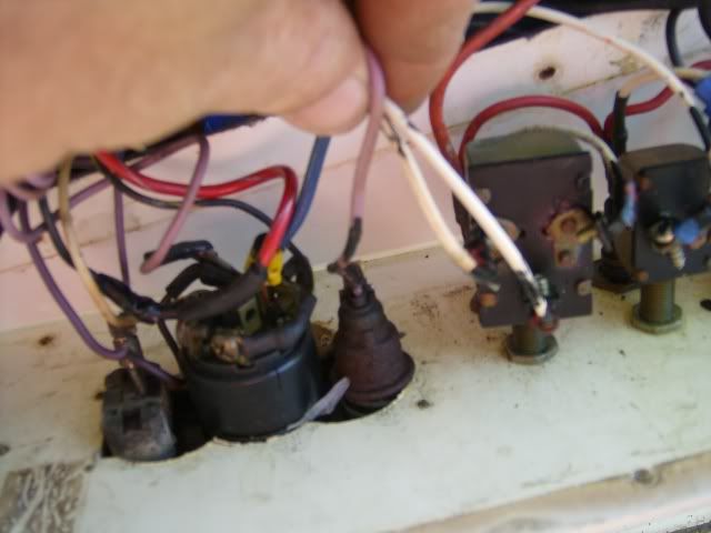

ok, I have some pics now. you will notice that the purple wires go to the temp light and choke. the blue wire that was on the ignition that went to the tach and the green wire (ground) was to a switch. Im thinking it was to the ground side so they didnt have to run it that far. you will see that the gray wire is loose.(I took a pic of it) I have tested this wire both with the ignition on and off but either way showed no power. Evinrude does call for gray for tach. now how would test to see where my problem can be? this motor was told was rebuilt so I would tend to think that my problem is either in the wiring or tach. the power I did have to the tach was the blue one and like I said that was from the ignition. does any of this make sense?

Snook, It is hard to decipher that spagetti from a photo. You want +12V in the ign pole of the tach. That will come from the ign switch, accessory pole. Normally they would run the hot light and choke on the accessory voltage. You want -12V (ground) on the gnd pole of the tach.
Now find the wire that goes to the stator wire and route it to the sender pole of the tach. This wire should connect to one of the yellow stator wires, upstream of the voltage rectifier or rectifier (whichever you have).

Whoever did the wiring on the cigarette lighter plug did that backwards as well. The metal shell of the socket is ground and the center terminal is +12 volts. If the red wire is actually ground, the wrong wire color is used. If the center terminal is actually +12 volts, then the wrong wire color was used there as well. If sensitive electronics are plugged into this and polarity is reversed you risk sending it to electronics heaven. This wiring needs a serious re-do.
