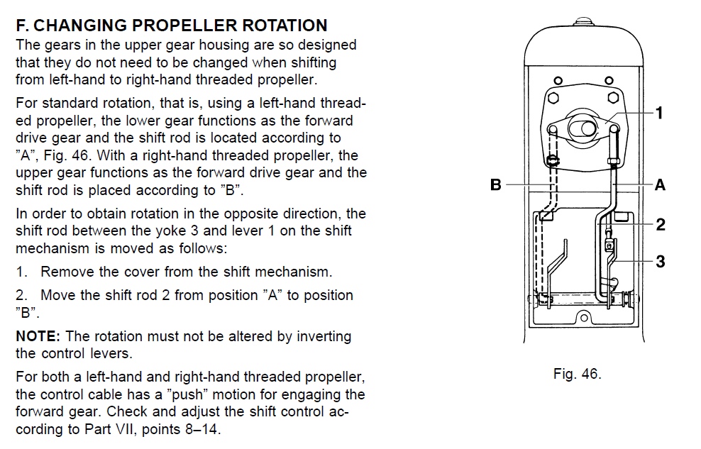

In addition to what Mark said, you can easily change the rotation on a 270 drive. Here are the instructions for doing so:
http://www.panix.com/~am_dew/270_change_rotation.jpg
Very tactful sir. Yes I did forget that on LH and RH installations, the prop shafts are turning in opposite directions so to make this work one has to do that.

So Basically I just need to change the shift rod from position A to position B and I'm all set.

Yep, that's it. I'd also replace the cotter pins used to hold the shift rod. As Mark said, you may find that your boat will list to one side after you do this...that happened on my boat and adjusting the trim tab did not help, so I switched it back after buying a different prop.

Just to verify.... Should I ignore this part? Or should I be doing something with the shift control? I moved over the shift rod as it said.
NOTE: The rotation must not be altered by inverting
the control levers.
For both a left-hand and right-hand threaded propeller,
the control cable has a ?push? motion for engaging the
forward gear. Check and adjust the shift control according
to Part VII, points 8?14.

No, by moving the "linkage" at the outdrive, you are NOT ignoring this.
It essentially only tells you that you MUST push the control lever FORWARD when you want to move forward.
Safety aspect since, if you did not move you linkage at the outdrive, you could just continue driving "forward" by moving the "control lever" towards the stern. If you at the same time happen to lose you your balance, you and other boaters might be in a very dicey situation with an accelerating vessel, possibly with a driver that is now overboard.
