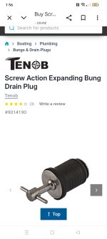

That’s my immediate plan until I maybe work out something for the original.
