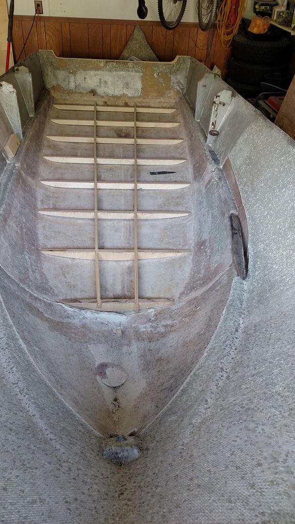

this is a photo of the stringer assembly I made to replace the original. I made it exactly like the original. the joints are half lapped at the intersections. the original half laps were screwed at the intersections from the bottom. this showed me that the stringers had been assembled prior to installation. only difference is that I glued the intersections with pl. the premade assembly will assure that the floor is flat. I am aware that this will be very hard to glass. I am open for advice. if I need to change it I will. I succeed through perseverance
61mysteryboat
Oct 22, 2015
104
It was rotted. I spent three days digging it out. I have the replacement plywood cut and fit. Just waiting to glass it in.

61, that stringer layout looks great. If I am understand you, you already glued it together? So that does present a new cog in the wheel. If the ribs, braces or bulkheads (whatever you want to call them) were fastened from the top instead of the bottom to the actual stringers, you could have installed the stringers in place first with the PB and then at your time and pace installed all the ribs, braces, bulkheads. Is there anyway to disassembly them. :noidea:

Yep,. All glued together😮. My main concern is getting the fiberglass properly fit into all of those inside corners. It would be possible to bed all of the ribs in pb. Cut the stringers out after the pb has set ( this would ensure that the ribs are level). Would it be feasible to not install the stringers and fill the area with high density pour in foam to add rigidity to the hull after the ribs are glassed? It is an 18' boat with 2" tall ribs and stringers.

IF, and this is a huge IF, you could get a few others to assist you, you could mix up enough PB to PB the entire assembly in at one time. But it would take a great coordination of everybody involved. The PB would have to be mixed on the light side of the MEKP issue to allow maximum usage time before it started to kick off. But each person would have to totally understand their portion of the operation to make it successful.
If you elect to go that route, layup the assembly dry, to get an idea where all the stringers and bulkheads are to go (ribs, cross members whatever ?). Then take a sharpie and mark where everything has to go ahead of time. Then remove it and see how everybody would install it again to those markings. If you think they can get it accomplished in a reasonable time, less then 10 to 15 minutes, then start the mixing. But a would also mix a few individual amounts instead of one large amount. Reason for that is when you mix a large amount it seem to kick quicker then smaller mixtures amounts.
And once mixed, start applying the PB inside all the marker areas and install the assembly. Get it exactly where you want it and level and using a plastic filler spreader(s), smooth the overflow PB on all the sides. After you do that, leave it along until it cures. And that shouldn't be very long either. Now you see why it would take some others to help. Too much to try and do with just yourself before it kicked.
If you don't smooth or filet the overflow, it will be very hard to lay the CSM and 1708 over the irregular PB hardened material that oozed out. The smoother the wood is to the hull, the easier it will be to lay the CSM and 1708. JMHO

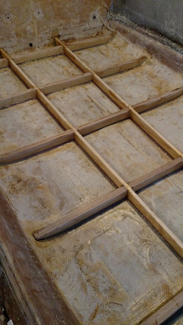

This is a replica of the original stringer assembly in my 61' starcraft. I made it just as the factory did. unfortunately it had rotted out. I pb'd the stringers to the hull today. The top of the assembly is rounded over. I raduised all of the inside corners with pb to make the 1708 lay easier. I made a mock-up of the intersection so I could see if the 1708 would conform to the corners. No luck. couldn't get the air bubbles out / wouldn't stay down. Trying to get fiberglass to conform to an X seems impossible. Is it possible to cut tabs into the cloth so sits on the top of the cross piece while draping down the sides of the other? Next, wrap the inside of the stringers. Then switch orientation to cover the tops on the next layer. I don't know if this makes sense but I hope it does. thanks for any advice.

I appreciate all of your patience and knowledge. I don't foresee any issues with the tabbing. Those pieces are fairly simple to run from the hull up the sides of the stringers. My main concern is how I will cover the top of each rib with one continuous piece of fiberglass. I won't be able to cover the "X" with glass and be able to get all four inside corners tucked in well. Is it OK to cut the glass at the intersection to get it to fit then cover those cut edges with another layer going in a different direction? Jb had posted a drawing showing each stringer "capped" with two layers of 1708 . That would work fine if there were no intersections. Hope this helps clarify my conundrum. Thanks again

Treat each compartment as an inside square box.
Get those all done and then work on capping all the intersections and top edges between the squares.
And you'll have to cut slits in the 1708 to get it fold down into each square as you run the continous cap strip.
If you glass each square up to the top rounded edge, and tab in each inner corner, the insude vertical faces are all sealed. So when you slit the cap strip and fold it down, there is no voids, unglassed or missing areas in the sealing envelope of fiberglass.
