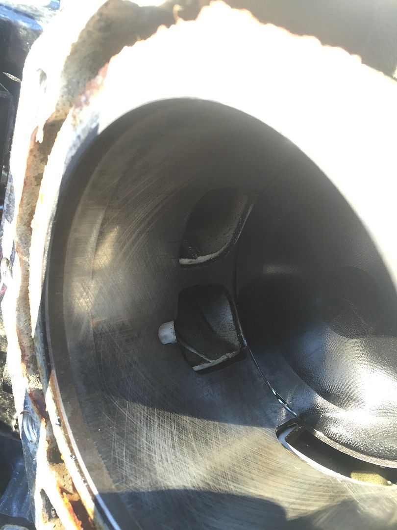

Ok guys so I went ahead and rented a borescope
From a nearby shop to rule out cylinder issues. The sleeves are not rotated or dropped, so I am very pleased to see that. There is some slight scuffing on the exhaust side ( big surprise for 15 year old motor) but nothing I can't live with for now. Actually all in all the cylinder walls and piston heads look very good.
Now I guess I will fire her up after I do a link n sync and see what happens. I have hope that the issue has been resolved!!

Anyways, got another one for you guys. Like I said earlier, I put a bore scope to this Mercury, and I didnt see any signs of turned or dropped cylinder sleeves. They all looked to be in the exact same location as one another. There was some scuffing on the cylinders, and as usual the top one was the worst. Didn't see any deep gouging.
