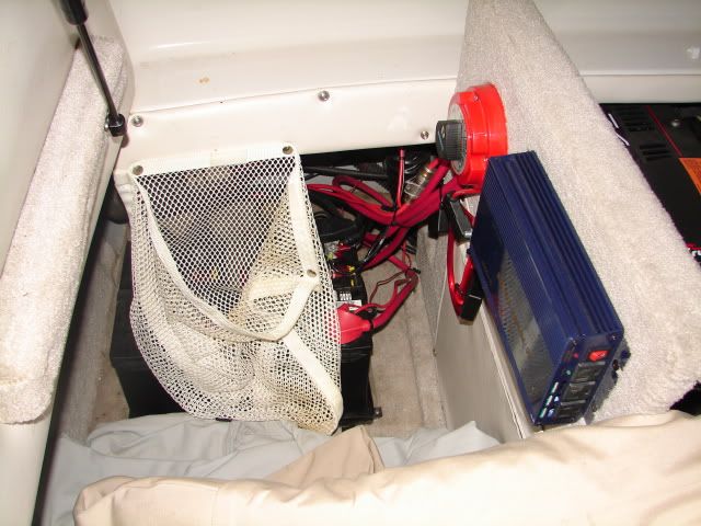

I have sturdy partitions on either side of my motor, carpet covered marine grade plywood in fact, I have both batteries on one side with battery switch and inverter, I also keep the bow and cockpit covers, inflatable tubes on this side (starboard).
Port side I have all spares, fluids and tools which is a lot, I have enough fluids to change all fluids in the boat, motor oil, outdrive, power steering etc, spare filter, spare impellers and spare serpentine belt, and the tools required to change them, I also have all my wash down fluids and microfiber rags on the same side, I have enough room on this side to include a 10" subwoofer. My Bimini goes across the top of the motor in its factory stow position and I can accomplish all of this while not blocking airflow from the air inlets on both sides of my boat. Finish the area off with a huge sundeck to cover everything and the Admiral has a place to sunbathe.
I keep nothing in the area where the motor itself is between the two sturdy partitions, I also have netting that goes on the back of each storage compartment this allows airflow from the inlets to go through the storage area through the netting, over the side exhaust and into the motor compartment from the back of the motor, excess airflow has two vents on the transom above the swimdeck, at speed this airflow is excellent, one of my transom vents also serves as the blower intake.
I think when it is done properly you can take advantage of the space around your motor, but there are multiple issues to be careful of, almost all of those will destroy a boat if not taken seriously so please be careful.
Here is the Starboard side while I was working on some of the electronics setup
