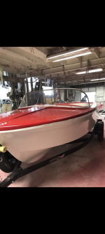

Hey guys new member here. I'm in the process of bringing life back into a 1964 Pacific mariner scimitar. On the back hangs a 1959 Evinrude lark 35, the 50th edition golden jubilee. This boat has a mercury quicksilver ride guide steering setup, and all I'm missing is a way to connect from the cable to the outboard. I've looked at several options and bracket kits, but I'm unsure what to get and I'm hoping you guys could steer me in the right direction. Thanks!

Yeah that's all I've come across as well, but what is interesting is there is no holes for a cable on the port side motorwell. so its as if this boat originally came with the push pull cable type steering. I'm not against changing out the steering system as long as I can retain an older steering wheel. Any recommendations on what I should look for?
Some more pics of the boat. The red one has been in my family since new, and is currently under going a complete restoration, also a Pacific mariner.

Thanks guys I figured I would have to piece it together, I was just hoping that wasn't the case. There are lots of ride guide steering connector kits online, Any chance you guys would know which one would work? I have the clamp, it's mounted starboard side of transom. All I need is to connect the cable to the engine lol

Update: got my hands on a bracket. Is the steering on these boats supposed to be mediocre? At full steering lock there is probably another 6" of travel left in the outboard to turn

A lot depends on the location of the anchor for the Cable and the distance from the Pivot Point the Cable attaches to the bracket. Those Push-pull systems work best when they utilize the Tilt Tube and are anchored to to it

Does the motor turn the same amount in both directions? if so, you are probably rigged correctly and the steering system is what it is.
If the motor turns more one way than the other, you may be able to adjust the steering cable length where it clamps into the holder. It also looks like some adjustment where the steering rod end joins the cable end. It doesn't look like enough adjustment, but who knows.
If that adjustment is not sufficient, I would think you could lengthen the steering rod end a bit. Perhaps a threaded rod plus two bolt couplers would work, if the threads are standard bolt threads. The cable end gets the bolt coupler, the threaded rod screws into that coupler, then another bolt coupler and then the steering rod end. use some blue locktite, and jam nuts as well to keep it all tight.
if the threads on the rod are NPT, some sore of pipe nipple plus 2 couplers might work.
If you cannot do that, some sort of plate or bar extension connected to the steering rod may fix it. It will need two bolts on one end to keep it from swiveling.

Yeah it just doesn't have enough throw. Played with it for several hours using various adjustments. Has anyone converted these to a hydraulic steering system?

I found a bracket and have it hooked up, there just
BTDT with my 1959 Johnson 35. The bracket shown in Post#11 by Chris1956 should work BUT you will need a "Clevis Kit" to make the connection between the cable end and the bracket Search the web for Teleflex SA 27314. Good luck!
Isn't an adequate amount of steering within the system to safely and efficiently maneuver the boat in my opinion. Has anyone tried hydraulic? I'll post pics of what I'm working with after work today
39,906
Remove those odd bits on the end of the steering cable.----Then see if it can be fitted to steer the same amount each way.
