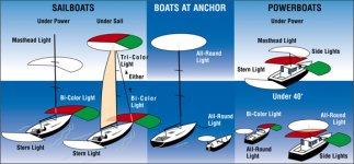

Aren't the nav lights and the anchor lights three different lights?
This is the way I'm understanding the nav/anchor lights, correct me if I'm wrong.
Red and green on the front and a white one on the back for nav lights. Only time the nav lights are on are when the boat is underway?
One white light on the highest point on the boat for the anchor light? For when the boat is anchored.

Correct, the three lights are ON when under way at night. The stern light becomes the anchor light when boat is at anchor. All three lights are controlled by on switch ON-OFF-ON (ON Nav lights-OFF-ON anchor light only)

I'll be mounting an anchor light on top of the console/t-top. The rear light is actually flush with the back of the transom and won't be able to be seen by someone coming from the front when anchored.
Then the white light on top needs to be ON when ever boat is running at night

The stern light is the same as the "power boat under power" upper pic. So it looks like I will have to have all 4 lights on.
