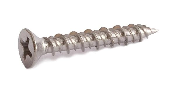

When I install my deck can I use sheet metal screw instead of rivets ?
Watermann
Jan 12, 2013
13,842
You can, I had good luck with the Sharx marine screws not coming loose but just think about what material the screws have to hold onto and all the vibration in a boat.If you're lucky 2 teeth on the screw are hanging onto aluminum.
The Sharx got some bite and don't shake loose. I still prefer rivets tho....
Very good point I didn't think about the thickness of the alum... I was just thinking ahead if for water ever reason I needed to to remove the deck it would be much faster if it was screwed in
