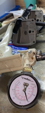

I'm still reading lots of threads learning and learning. I've seen a few threads where someone tells them to test the compression again. So this time I rented a compress tester from Napa.
I got:
126, 134, 126, 128.

I took a vacuum tester and hooked it up to the line that goes from the fuel pump to the carburetor bowls. Pumped it up to 20 and let it sit for 5 minutes.
It didn't drop pressure one bit.
