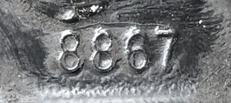

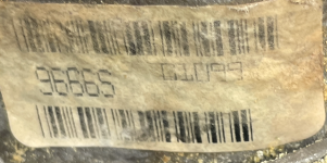

Please help identify model info:

Ayuh,..... It appears to be the Merc/ Weber AFB carb, which is a carbon copy of the edlebrock 1409,.....
For a rebuild kit, or other parts, edlebrock is cheaper than Merc parts, 'n just as good,..... better maybe,.....
