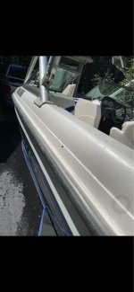

I am looking for advice on how to repair this spider cracking on my Moomba. Is it best to dremel out the cracks and fill with matching gelcoat, fill with a fairing compound and gelcoat over, etc.
I'm open to suggestions, I have watched several videos and I have seen quite a few repairing the cracks with fairing compound.

I recently did the same repair on my Century CC , I v-grooved the cracks with a rotary, filled and faired with 3m vinyl ester compound, and sprayed color matched gel with Duratec. Its basically un noticeable now

I've always been to grind all the way through the gel to just at the glass. If you don't the crack may come back. So I do it like that and have no issues.

Yes, grind and repair is what is covered in the stickies

Grinding that section of the cap and trying to get it fair again is a big ask. You will see the repair area everyday.

Good deal, do you use a fairing compound to fill the voids and re gelcoat or do you fill the voids with gel coat?

Well, on mine I filled them with epoxy, and small amount of fairing compound. I painted mine. At the shop we fill with gel, unless the damage is deep, then thickened epoxy, then gel.
