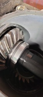

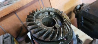

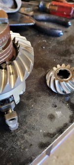

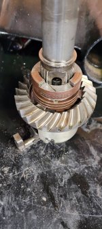

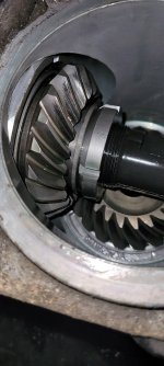

I'm glad that you posted this because I didn't realize there were two different ratios between the upper and lower units. Like my other reply, I will look for separate units.lol yep, missed that. Well the one in the pix is from a 3.0 seeing as how the engine is right there, and here are the gear ratios from my old OMC manuals:
2.3 liter Ford: 2:1 overall, upper 21:21, lower 13:26
3.0 liter GM: 1.71:1 overall, upper 21:18, lower 13:26
so the question really is, would you be able to compensate for the taller gear ratio of the 3.0 drive, by changing props to make it work with the 2.3? That, I can't say for sure.
