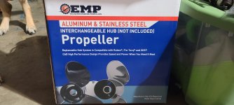

You'll need to be more specific with the props. What are the makes, models and steel or aluminum. Hard to believe the 17 only turned 10 more rpms than the 19 unless they are different prop makes or families. 46 mph is moving out and decent performance for this boat.
Good question, it's an EMP Aluminum and stainless prop. EMP is Engineered Marine Propellers
2ndly, I'm using the data from the mobile vessel view. Regarding the rims and speed, my trim adjustments and accuracy are enough to account for probably over 200rpm differences... I'm also trying to ensure I don't overrev... no doubt I could trim up and get more rpms

When you go to a 4 blade prop, you typically drip 2" in pitch, not use the same as your 3 blade. You may very well need A prop for cruising and another different prop for skiing.
