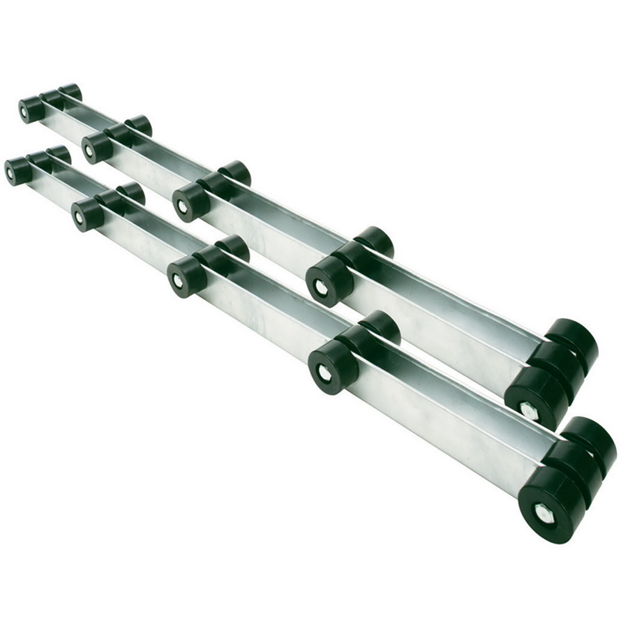

Have to agree for the most part. Problem I am looking at is the size of the roller axles or wagons. Many are not adjustable for length or width within a set of rollers. Sure they can be moved in or out, forward of aft to some degree but the distance between the rollers on many wobble trucks/wagons do not have any adjustment.

I have limited experience but I would think that any trailer with rollers that can not be adjusted is a hack job.
My old Holsclaw has arms that raise or lower and can be positioned in or out for width. The can actually be configured to position the roller above the fenders for a really wide boat. The port and starboard rollers mount to the arms and can then pivot to conform to the hull. Once in position they are locked into place. All the keel rollers can be raised or lowered to match the hull design.
I reconfigured it from a v-hull to flat bottom in about an hour. With frozen bolts it would take a lot longer. I replaced all those a month or so before I bought the newer boat.

On many of the older Caukins, Spartan and even EZ Loader trailers the wobbles are not adjustable between one pair. wish I had a picture of my Spartan.

I don't think that non adjustable roller trucks will pose any problem

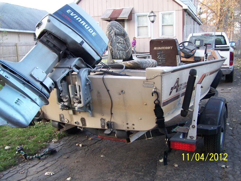

I'm beginning to believe that fitting a trailer isn't always easy as some may think. Following this forum and craigslist looking at boats I have seen what looks like way too many mismatched boats and trailer. Such as the trailers are too small or too large or the bunks do not line up well with the shape of the hull.
When I purchased my Lund it was on a roller bunk trailer. The strakes under the boat made it difficult to position the bunks because of the mounting holes in the trailer. No matter which way I moved the bunks they were right up tight to the strakes. So when I replaced the bunk boards I put them on the table saw and ripped about 1/4" at a 30 degree angle the length of the board which then gave me about1/2" either side of center to stay off the strakes. The Spartan roller that is under it now was much easier to adjust to fit.
Here's a picture of what is under this boat now. I know pictures can be deceiving but right now this is the best one I have.

OK, I didn't realize you had that little water at the back of the trailer.
Doesn't change what I said, wider facilitates lower, and lower is better.
After you hit the garage door frame a few times, you'll hardly notice it. LOL :D
I would not worry about having a trailer that has a higher capacity than needed.
If you really want a cushy ride for any boat, you're gonna need coils and shocks.
Certainly don't get a trailer that is under capacity, as suggested above.
Hard to make any suggestions as to which trailer will work for you, other that to find one like you have under the Lund.
I haven't seen a roller trailer where the individual rollers could be moved, in years.
Measure the distance between ribs/strakes on the hull and go tilt trailer shopping.
How about a single line of rollers on each side, instead of the roller truck assembly?

I would say that looks good. Keeps the center of gravity low, and launch and recovery easier due to how low it sits, and it is wide enough to be stable, and make entering and exiting via the fenders a breeze. My brother inlaws Karavan trailer is just like yours. It cradles the boat down low.
He's looking to replace the trailer in the photo, with a tilt trailer, so he can launch 'n load in 8-10" of water.

and honestly that wide low trailer is likely as high or higher due to the 13" or 14"? wheels than a narrower one would be with 10"-12" wheels

Sorry had to get to bed so I could work last night. Let's see if I can answer everyones questions and concerns.
Normally there is about 12 to 15" of water at the end of the trailer where I go though much lower this year. I don't think this one still sits low enough to get the boat back on. With the Lund once it is winched up flat on the trailer the bottom of the boat is out of the water. The adage of launch deep, retrieve shallow does not apply here. It's all shallow!! I think I'd have to back the truck 30' into the water before it would be deep enough to float off.
It's not that I dislike this trailer I just don't think it will work at this launch point. Yes this does sit much lower than the Lund and that trailer has 5:30X12 tires on it. But it works because it tilts and I can get the rollers under the water and under the bow.
This Shoreland'r does have single row wobble rollers under the stern. Again just not certain they will be low enough.
As to load capacity I was thinking in the 1500 to 1600# range or a 2000# if I can find one that fits well.
The Spartan I have has 4 wobble rollers per side and then 3 keel rollers up the center of the trailer. Many of the roller trailers I'm seeing now do not have keel rollers but usually another set of trucks amidship and just one keel roller. It's these more forward rollers that I'm most concerned about getting to fit as again many I'm seeing are much wider than the stern trucks.

Another thought I had while at work last night, some of the trailers I'm seeing have the wobble trucks that have a lot of up and down movement to them like my Spartan. I'm now wondering if those will drop low enough to be able to get the boat uponto the rollers.
