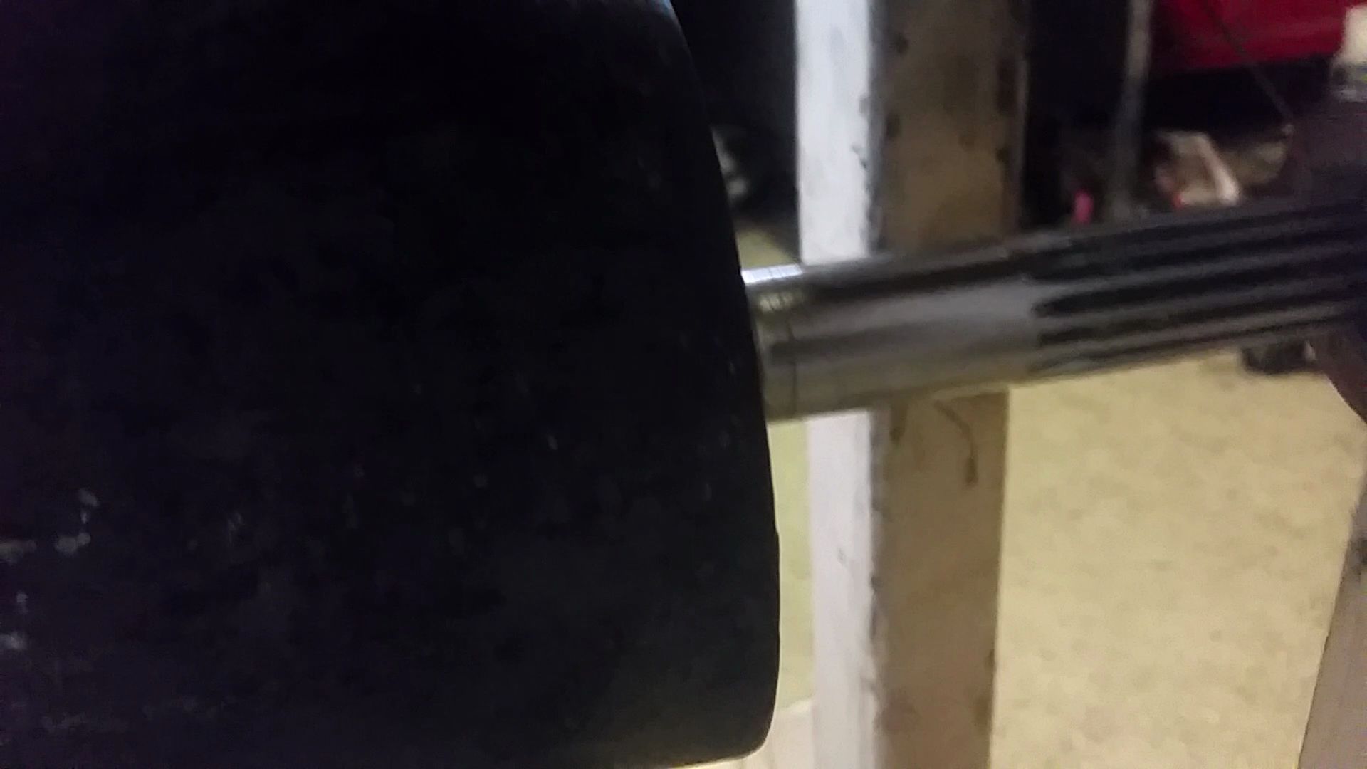

Everything looked good to me. I'm posting a video of the prop shaft and the amount of play in it. Keep in mind it's been like this for five years now, just not sure why?
Jan 7, 2016
28
This is the prop shaft play. Anybody know if this is excessive. There is nothing broken. Pin goes through, nothing seems worn out or broken
Bt Doctur
Aug 29, 2004
19,480
what I see in the video is prefectly normal, with the propshaft fully seated in the housing ,the propshaft itself will have about a 1/8th inch movement when fully assembled. If the propshaft still moves more that an 1/8th inch you have to find out why.
