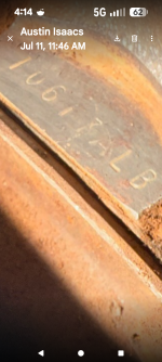

14015445 is block number

Oval port heads.i posted the head casting number in the beginning of post.Also pic of specs are above.
