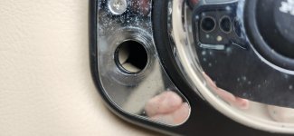

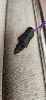

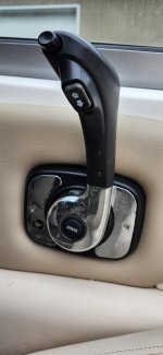

2008 20' Chaparral. Pictures attached.

I agree, it looks very similar. Can't tell if the hole size is the same.

I would suspect that yours and this one are not only the same item but made in the same factory somewhere in the east. Given its free returns (at least that is what I see on my account) its no risk. And if not, it’s a $30 risk. Go for it :)
