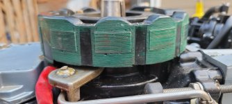

Does anyone think this is a problem?
Not a problem at all. That's just a shellac or coating they spray on the lamentations so they don't rust. I could be wrong but I'm fairly sure that's a aftermarket or re wound coil. All the original omc stuff I've seen has had an amber colored shellac on it. But I could be wrong. Either way it shouldn't matter
