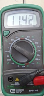

Everything seems proper? I'm going to put new spark plugs in tomorrow. When I remove the purple wire the motor dies. Do I need to run a wire? Do i need a wire up to the key switch at the helm from coil +? Then remove purple wire?

I meant verify that you have the proper coil for your kit. Some call for a resistor wire and some don't. I think all of the modules need a full 12v. If you need 12v you need to run a wire from the choke. If the coil is internal resistor your then it also needs 12 volts. Otherwise, you keep the resistor wire. You aren't measuring correctly in your video. You want coil positive to engine ground. It should be 12+ v if not using a resistor wire and 8-9v if you are .

the engine starter key 12 volts coil ..... then the key 9 volts engine runs ...
purple wire resistor 1.8 resistor coil + engine on !
