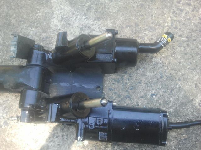

Thanks! I found there was a small set pin holding the main pin in the upper pivot point of the large arm. I finally got it all off. My trim motor is OK. There was a bad connection at the battery which somehow decided to act up instantaneously. Was good one minute, acres dead the next. Which is how the old trim motor acted when it quit.
Anyhow, back on topic. I'm assuming the aluminum cylinder that attaches to the trim motor is the pump itself. I replaces all the o rings on this. I now want to get the cylinders apart while its all off the boat and on my workbench and replace the seals in them. I thinking my problem lies inside them. I think fluid is bypassing the seals in the cylinders. Which could explain why it works better if I stand on it. It puts pressure against those seals again. I can push on one of he small cylinders and the other one extends.
I don't, however, understand why it was fine before I removed the trim motor, put it back in, and I have this problem. I did have a leakdown problem before, but only a small one. It would leak down from full up over a few hours. I planned to fix that this winter :(.
If I can get these cylinders apart while its off, and replace those seals, I will be good to.go!
When I wait the five minutes, do I remove the fill cap to release te air? Or the manual release valve?

Thanks. Anyone know how to get the cylinders apart to change the seals inside them? I changed the seals on the pump, but I don't think they were my problem. They looked OK. I think the new fluid maybe washed the old seals or something in the cylinders. Its all I can figure that makes sense. Does that little pump (cartridge pump) ever quit working properly for any reason?
mwe-maxxowner
Master Chief Petty Officer
Jun 20, 2012
825
Re: replacing trim motor on 84 mercury 150
Is there a cap on the end of the cylinders that is removable somehow allowing me to service them? The system would work great till the two small cylinders were extended and it was all up to the long middle cylinder. Then it didn't really wanna push up.
I found a guy reconditioning used ones and selling them (the whole unit), so I'm sure it can be taken apart.
