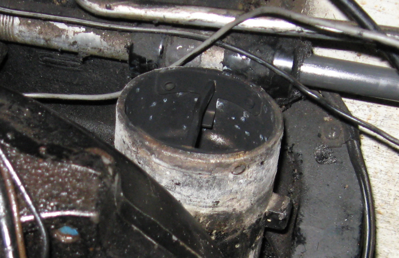

I have a question about the exhaust flapper. Google and forum searches reveal that many people recommend AGAINST putting in a flapper, since it can disintegrate and partially clog up the exhaust passages. Others seem to feel that it's a good thing to have.
Removing the head reveals to me that my flapper is not present. (I'm assuming the exhaust flapper hinged on the piece in the picture shown).
Before bolting the head back on, now would be the easiest time to replace it. Any opinions on whether the exhaust flapper is better replaced or left out entirely?

Replace the shutters, they will keep water from swamping the exhaust (and cylinders) if you take a wave up the stern. You need to drill out 2 of the rivets and replace them with SS screws and nuts.

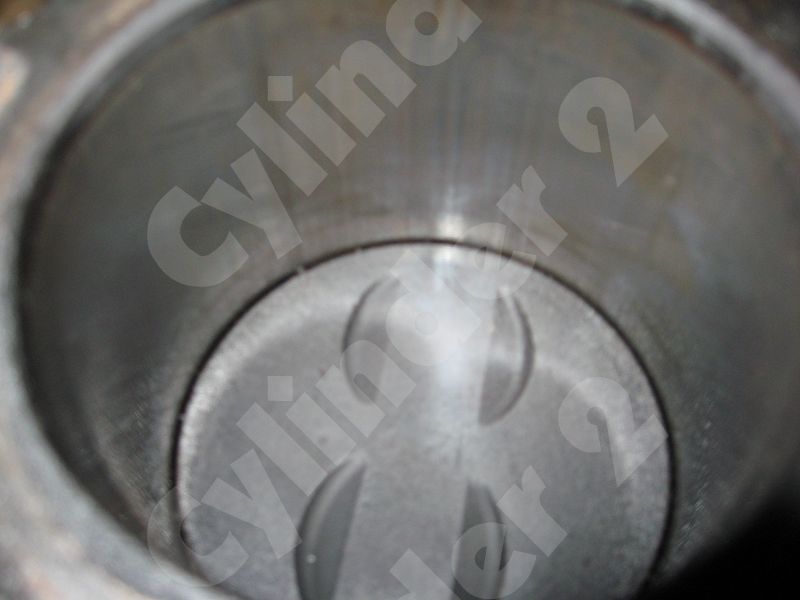

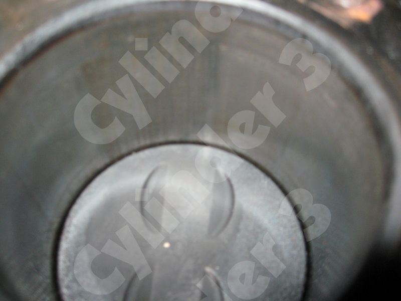

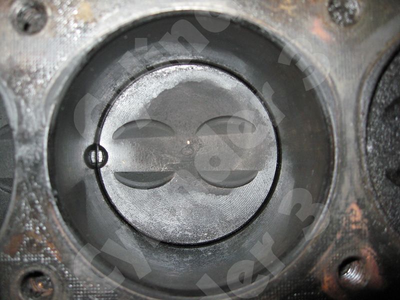

Any pics of the cylinders?

Yes, here are some shots. Pistons are up in C1 and C4, since I was most concerned with C2 and C3 (the initial problem was low compression on 2&3).
Cylinder #2 (piston down) shots:
Cylinder #3 (piston down) shots:
My Canon is perhaps not the best camera in the world to take these shots.

Hey, the block looks like it has erosion between the 2/3 piston bores. If the block is not "skimmed" back to a flat surface, your new gasket will blow through at that spot again.
