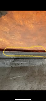

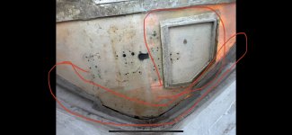

Hi I’ve got 1976 storebro 31 biscay twin diesel motor boat in the uk , im currently In the process of repairing the fore deck core from the inside ,only the front 1/2 of the fore deck around the winch and the cleats etc , this is originally made up of ply and balsa ,I’ve used Moisture meter to identify the wet part and I’ve got back to good balsa , I’ve left 2” Perimeter around so I’ve got something to glass to , I cleaned all the old balsa and plywood out of the perimeter, my question is can I fill this void with epoxy thickened with cabosil or similar because it will be very hard to try slide the new core ( was going to use armacell pet foam ) into this void and avoid any air pockets, part I’m repairing is quite rigid due to a chain locker bulkhead, hope you understand what I’m trying to do is this a good plan ???

I would trim the lip off, grind it back a bit for proper tabbing, and not have to try to stuff anything in there, just bond the new core. there are many on-line tutorials about re-coring sailboats that you can get some pointers

I’m a bit reluctant to trim the lip back as there wouldn’t be enough to tie into when I put the inside skim back on, it would mean fiberglassing right back to the hull joint it’s just to tight up there to be trying to get the fiberglass to conform to the shape , it’s going to be hard to do it with the lip but without the lip near on impossible, on the photos it looks easy but trying to squeeze into the pointy end is very hard , hence why I spent so much time cleaning every last trace wood out of the lip

the break the core up. the core is to take up space between the two layers of fiberglass. to separate them and keep them from compressing together.

I would fill the voids with PB, 1/4" cut glass and cabosil as my mix. Make the pb thick so whereas you can hold the mix upside down and it doesn't drop out of the container. Then its time to go to work. The cut glass is the strength. Pb is no strength except for as a glue.
I would also use ply that has been wetted out that was cut to fit to place. Key word is cut to fit then wetted out and dried. All edges have to be soaked prior and dried out. Then apply pb to adhere the wood. Also the wood could be prepped as pcs,. or as 1 pc. like a puzzle. If its pcs. then again, the voids need to be filled with pb as stated above.
Its a process thing. Ie fill, sand etc...
Glass it 2x and have a great day.

The down side is youwill be working upside down and fighting gravity.
That, in my opinion makes the job harder than redoing the top of the deck and the non-skid
I have a soft spot on my foredeck that is from a crack in the fiberglass that exposed the balsa to the elements for a short while While that was glassed over 5-6 years ago, the balsa appears to be soft now in one spot. After helping do the deck on a buds sailboat by spending 4 hours in the v-berth laying on my back and fighting glass matt falling on my head, i decided when I tackle my foredeck, im going thru the top
