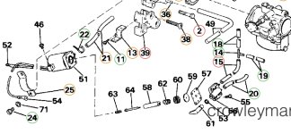

Started it to check the new water pump impeller and when I pushed the key in to choke it, fuel was seeping out around the base of the red knob. Is this a manual override ?
Or a bleeder ? There is a Schrader valve in it ..... what is the NOP for this guy ?
Looks like I just need to change the O-ring (53) to stop the leak, but am wondering about the rest of its intended operation.
Thanks

39,904
The red lever is for manual operation of the valve should you have a dead battery.-----Yes this motor will start / run with a dead battery.-----The shreader valve allows you to inject engine tuner or storage oil while motor s running.

Now it turns from seated closed to about 90 degrees open.
I assume there are stop lugs for the red plastic lever underneath .... which is split on one side. Do I splay the plastic to get it off ? and the valve out ? Or does it slide off ?
Quite tight, doesn't want to slide and I don't want to break it ... being so old (not me, the red part)
Thanks again !

Get yourself a rebuild kit for the primer.
It will be pretty much self explanatory from there.
