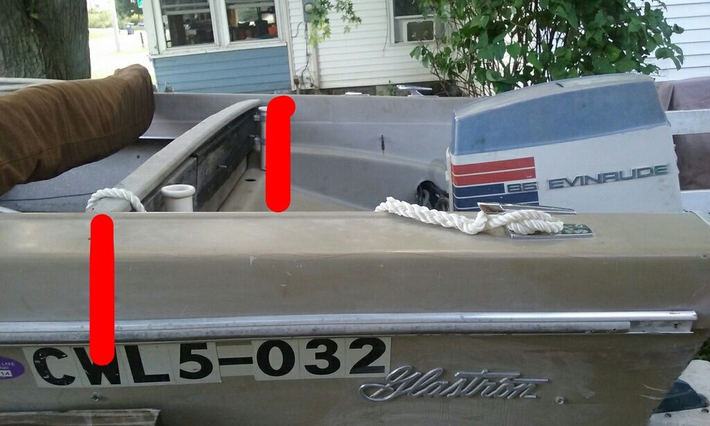

Transom repair 1963 Glastron
My transom is rotten and leaking, really a bummer, but I rushed into buying this pretty little boat. What would be a good approach to this task. I've never worked with fiberglass before. What would I do about the angles gunnel? Would need to cut the "fins" out? Going to remove the side part that the battery and spare gas can sit on and post pics tomorrow maybe. I may need a day to morn :(
Any tips would be very appreciated.

Due to the way your boat is designed you have 2 choices on how to replace the transom. 1.) Cut the gunwales about a foot in front of the spashwell and then you can remove it and gain full access to the stern. You'll need to cut away 2-3ft of the deck too. Then use a circular saw set to the depth of the plywood and cut a kerfs in the transom approx. 2" apart both vertical and horizontal. You can then easily chip them away with a hammer and chisel.

Thank you for the response Woodonglass I guess the first thing I need to do is get the motor, seats, controls, and electrical disconnected and off. I'm hoping from there to drill out the rivets from behind the rubber dock rail and maybe the cover will just pop off? Gotta wait till I can get a hand with the motor cuz she's a bit stout.
What's the second?
Woodonglass
Dec 29, 2009
25,932
2nd method is to remove the entire top cap. Litlle bit more involved but...Keep you from having to repair the "Cut Line" in the gunwales.

Thank you. I'm going to spend some time reading the forum rules so as to not draw any more attention from the authorities lol. Old habits die hard. Anyways, I'm thinking I'll cut the splash well out here exposing the transom. The next step will be getting ppe. With the $20-30 3m 6000 mask be good enough?
