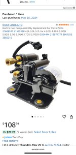

By the way the fuel pump I purchased is not OEM it’s from Amazon , do you think that’s the problem ? It’s exactly the same of the original , do you think I need to install the original???

This is the fuel pump I installed last year i ordered it from Amazon , do you think this happening because it’s not the OEM ?
no, I think you are down on power because you have cylinders in the 120 psi range.

This is a 5.0L 270HP FI Volvo? If so...I'd be double checking that fuel pump.
I say that as mine went in the Four Winns - same engine. The cost of the pump alone, from Volvo was $1k. This is one area I would not cheap out on. The cost of the Amazon unit makes me pause.
So you think fuel pump could be the problem because it’s not OEM ????

I think it *may* be part of your issue if it can't supply enough fuel to the engine.
Given the price point (at 1/10th the cost of OEM) and suspect manufacturer...I'd be checking that.
When mine went, there was an audible noise where you would hear it run, the noise would stop, the engine would die. It was a very nasty idle out from the ramp and back trying not to get hit from the folks behind me.
