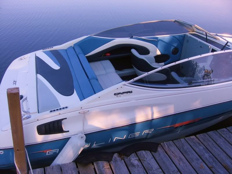

Re: Re-powering 3.0L -> 4.3L? Is it difficult?
What boat did you do this on?
92 Bayliner 1851CB
still says 3.0 below the "Capri" to this day.meant to peel the decals off.
drive ratio is not the same. you also need to buy a Y pipe for the exhaust. I bought a complete 2008 Merc manifold and Y pipe set up new from ebay cheap so I have dry joint manifolds which are sweet..
Does your 3.0 have power steering? You'll probably want to consider that on a 4.3
There was a 4.3 version of my boat model offered in 92, but my hull was only set up for a 3.0 -was not built with side mount pads - had to build them.
Bayliner didn't put anything in that wasn't exactly what was called for on that unit.
This is actually my 2nd swap from 3.0 to V6 - I also converted my Grew 175. It has a 17 gal tank. I can empty it in an hour :(
That's why I made sure this boat had a big gas tank before beginning.

Nice boat!
