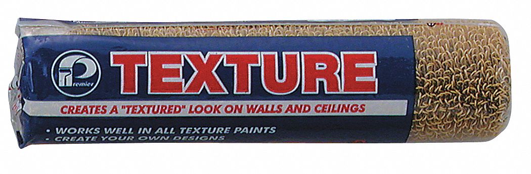

About 15 to 20 Sq ft per qt when rolled on. I'd recommend 2 coats. First one roll on with a normal roller and on the last coat Use one of these
24K692_AS01
And add a 1/2 quart of Cabosil to the mix to thicken it enuf so it does'nt flatten out and fill in as much You'll get a nice textured finish. Make sure and put wax in the last coat of the Gelcoat.

Does anyone have a picture of the above method, or something similar? I'm going to gel my deck too and am having a hard time imagining this textured look being as attractive as a top coat rolled with a regular roller, but left unpolished so it's not so slick.
