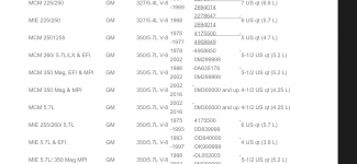

There are two oil quantity specs for these engines. It’s in the manuals

Thanks for that QBhoy. What manual is that out of?
It’s off the internet to be honest. I looked at the Manual for my engine and it suggested over 5 quarts to be honest. But it’s Defo not. Then I remembered that there was revised info on it since.

My problem is that there is no tag with a serial number on this engine, just the casting number on the bell housing and 880 on the side of the block

Interesting follow-up...I finally heard back from the company that supplied the rebuilt engine for the PO. I asked the exact question that I originally posted here. This is the response;

Not conclusive for me. They're just quoting stuff from the aforementioned manual(s). I'm going to stick with what QBhoy, Scott and I have field determined.

So I finally talked with the guy that runs the shop that rebuilt the engine. I am going to share exactly what he told me, so take it for what it is worth or disregard entirely........first I was trying to determine if the long block actually had an oil pan installed or if the original pan off the 5.0 was transplanted. He verified that the 5.7 pan and new pump were installed at the shop.
Then we had a lengthy discussion on oil capacity, oil types and coolers. I asked a lot of questions and he answered them all. Basically he said that it didn't matter how much oil you put in a small block chevy style engine with a stock pan as long as it was between 4 and 7 quarts, but his opinion was 5.5 was the perfect amount. He said if you were just going to putt around the marina with the engine idling then a minimum of 4 quarts was just fine, but if you wanted to haul A$$ and run the thing WOT then you better have at least 5.5 quarts in it to compensate for the amount of oil being pumped through the engine at high RPMs and still have enough volume left in the pan to not starve the pump.

Hmm, well Bama your guy certainly sounds like he knows his stuff. I may start going with 5 qts.
